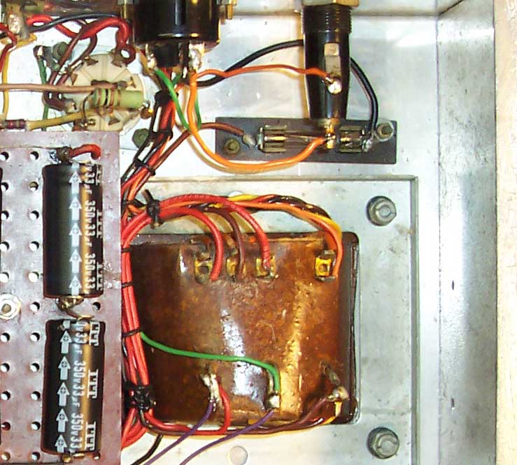

Possible. These flat fuse holders in this amp have a single hole in the center to mount them.
Post by VelvetGeorge » Fri May 30, 2008 10:00 pm
Here are a few pics that may help clarify.
VG
