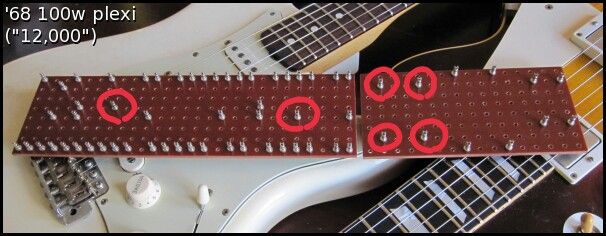

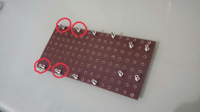

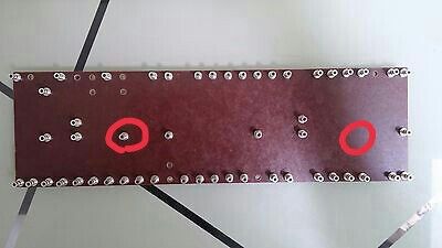

I found a turret board on eBay priced reasonably, but I have a few questions regarding it. Valve Storm, I'm not ruling out your product by any means, just researching my other options! I used Brian H's board as my "standard" as his turret boards seem to be liked by many of the forum members in various build threads. When comparing the board on eBay to that of Brian H's, there seems to be a few differences. I've circled the differences in the following pictures:
Brian H's Board
eBay Board
Will these differences prevent me from building a 12,000 series the same way I would on one of Valve Storm's boards? This is my first build so I don't want anything that is going to throw me off when compared to other's builds using either Valve Storm's or Brian H's boards because I will definitely be referencing their pictures and build journals!

Re: First Amp Build - Advice Needed!! ('68 Super Lead)
If you are a first time builder I suggest you go with a fully perforated board like the bottom one from Valvestorm. The nicest version was the one from BrianH, he no longer builds them and has no plans. I would be interested to se what valve storm has planned.
I used to make my own boards but then went with BrianH (he could make and ship them as cheap as I could buy the board and turrets!).
From a technology point of view the red swirl material will be much longer lasting and less likely to absorb moisture and become conductive like some paxolin boards do in a damp atmosphere.
When you build I strongly suggest you put the interconnecting bus wires on top of the board and loop your wires that go of the board up through the adjacent holes (like the 69 SL amps). It makes testing and trouble shooting much easier. The taller split turrets were used by Marshall up to 68 but both styles are pretty easy to use.
The valve storm/metro option is a much more authentic build c/w Ceriatone but in their own way the Ceriatone and other options are not bad.
If you are after a high quality keeper amp then I suggest Valvestorm/Metro with the self lead 1998 Dagnall OT. People say the ****** OT of same spec is very good but it is more expensive and I have found his business dealings for UK people a bit flaky, as has another longstanding and upright (i.e. honest) board member in the UK. In the US you might be fine
