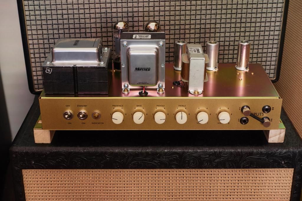

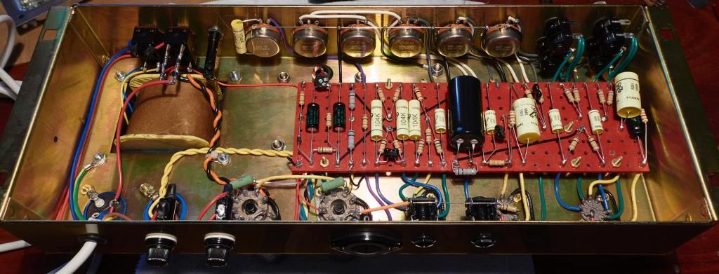

I haven't been here for ages - I've built quite a few amps using the wonderful Metroamp parts. But i just built another which some of you may be interested in. I used the Metro 50W steel chassis and a JTM45 board, because I've always wanted to build an amp with one of those old-style boards with all the holes drilled through. :-)
But this time I went with a Merc Magnetics set of trannies - a 10 Henry choke, a 50W plexi O/T and a lower B+ 50W P/T. I'm getting right on 400VDC on the plates, which is significantly lower than any of my previous plexi builds. I wanted this amp to be easier to use at lower volumes, as a 50W plexi is so loud!
My use is probably very different from most of you here. I play jump blues and rockabilly with Gretsches, and these days prefer 1x12 combos because I am over lugging heavy amps to gigs. I have been using my own tweed amp-based designs for a few years now - mainly EL34 tweeds based on the 5F6-A or 5E7 circuits. I use beefed up P/Ts so I can run EL34s. Well this time it's all Marshall.
I don't have the cab yet, so I have been testing it through 1x12 tweed cabs with either a Celestion Gold or a G12H Creamback. Cranked it howls of course, but at lower volumes it really sounds beautiful. Warm, clear, punchy - like a tighter, clearer tweed. The low E string on my P90 Gibson 335 sounds like a piano string. Very happy! And I don't need any bright cap on the bright volume pot - it's plenty bright without it. It's a big, fat, warm, wonderful sound. I think the lower B+ and no bright cap lets me use it at a lower volume than my other 50W builds. The sound difference is subtler than I thought it might be, but I love it anyway.

On the lower B+ 50's it can be cool to bypass one of the 10k 2w resistors. This way the preamp gets normal high voltage but the output section is lower.
Roe
Posts: 5056
Location: Drontheim. Norwegen
Re: Lower B+ 1987 build
Post by Roe » Sun Feb 08, 2015 11:25 am
VelvetGeorge wrote:On the lower B+ 50's it can be cool to bypass one of the 10k 2w resistors. This way the preamp gets normal high voltage but the output section is lower.
yes and reduce the screen resistors carefully

Hey George I was wondering about that. When I went back and looked at a schematic I had drawn up directly from an '82 2204 I had years ago it had a single 10K dropping resistor instead of the pair. I decided to use a pair to drop the B+ to the preamp just to hear what it sounded like.
Which makes me also wonder - why did they use two 10k (or 8K2) in series? Why not use a single 22K or something? Was it to prevent the resistor overheating?
Originally 1watt carbon comps @8k2 for between screens and pi and 10k between v3 and v2. Later carbon film Iskras (later Pihers and some grey MOs). With one big R too much heat dissipated, high predicted failures.
With higher preamp voltages you get a clearer brighter peramp with more headroom so if you like that but browner response from the power amp I am sure the suggestions above are the way to go. I had a toggle switch JMP50 lead with a 395v B+. Sounded best with a single 10k first in line (of course had a 10k between v3 and v2 and another between v2 and v1.
I that it is something we often neglect (or at least I do :oops: ) is the optimum voltage for a preamp valve to wirk at its best, we obsess about output valve plate voltage and bias assuming that when that is correct everyhting else downstream will automatically be correct too.
Wonder if George has an ideal preamp tube target voltage in a plexi? :wink:

I went with the single 10k dropper myself after trying it both ways during the build of my 1986 clone. Really liked the increased clarity.

Good call guys! I went with the single 10K after the choke and yes, it sounds even better - clearer and maybe even a bit more sparkly or something. I also cooled down the bias a smidge. All in all it actually sounds fuller and better, which is quite an achievement.
The clean sounds are just amazing. I can't crank it just yet, so I'm using my favourite dirtbox and it is one of the best sounds I have gotten so far. FWIW I must have been measuring the B+ unloaded before - now I have 379VDC on the plates and I'm biased at around 42mA. It is just a beautiful sound. Better than any Matchless, Vox or Fender!
