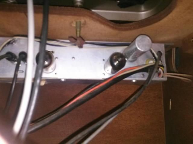

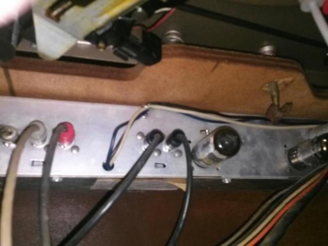

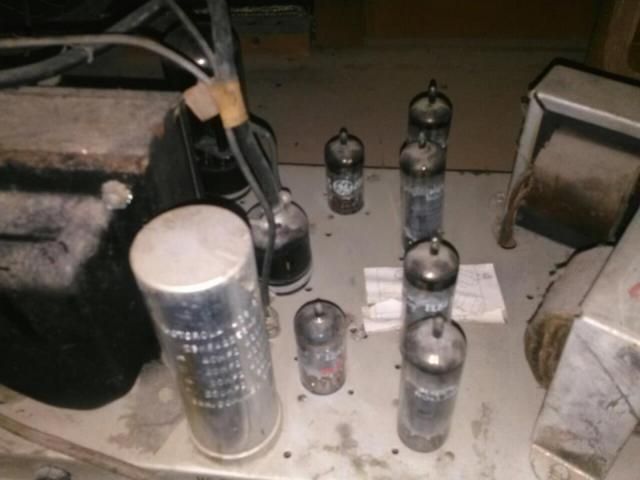

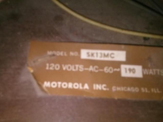

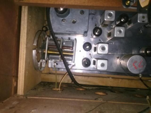

The top picture is what I think is the output section, next are the tuner and then the switching/control section,,, the last one is the tag with the model number ect… … he didn’t send me a shot of the turntable.

Hard to say exactly what it is. But the first pic indeed is your powersection. Looks like a stereo amp. On the right the output tranies. On the left i think the powertransformer. It looks like there are 2 powertubes on each trannie. This can mean it's a push-pull poweramp.

*Pictures from The Google* - motorola HS -696c
It Looks like Push-Pull... two 12ax7 before two El84 are the PI. There are another two 12ax7 on the preamp, and 5U4GB rectifier.
Old marshall 18 watts amps are used to have transformers from the radios. So those transformers will be just perfect!
You have most of the parts to build OR two Marshalls 18 watts or one VOX AC30. I don't think those transformers will be good for the AX84, since they are for a PP amp. AX84 is a single ended...
For marshalls you will need power transformers and some other parts. For AC30 - output transformer and some other parts.
Push-Pull and Single Ended are the types of the power amps. PP is more powerfull than SE, since the signal is devided on the two halves and each one of them is amplified by a tube (or transitor or OP-amp...), then a transformer connects them together.
SE - is amplifing the hole signal (360 degrees) and it's more clear and has less THD (Total harmonic distortion) than any other type of amplification, but it can use only 20% of the max power. Hi-Fi audio is the realm of SE amps.
