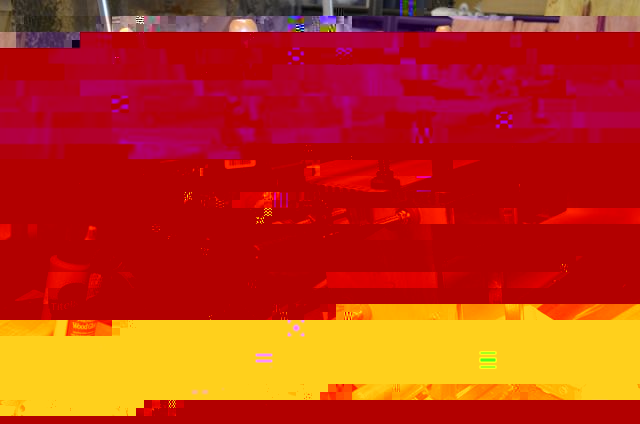

Post by 6burgh » Sat Jan 05, 2013 11:50 am
Finally got around to finished the plywood encasement last night. I've got to go to a woodshop to borrow a jointer to ready the curly cherry board for the table saw, so hopefully things will pick up pace. So far so good though...
First the sides are router to ensure the profile looks right when finished...
Then the top, sides, and bottom to make the right corners and flat lips...

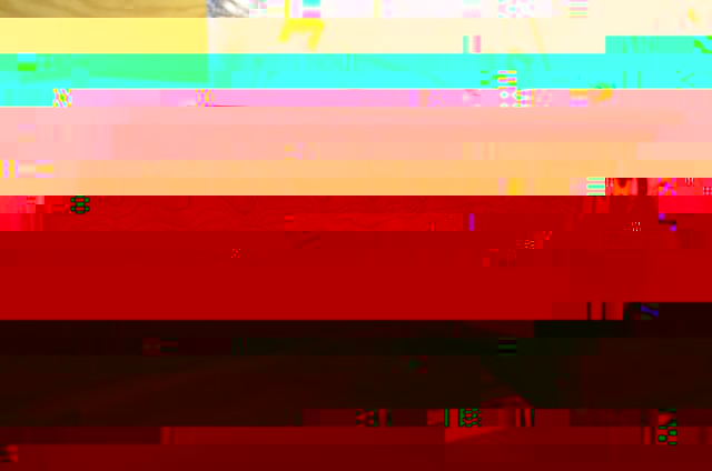

Okay, it's been a bit hectic. Finally had some time here and there to make a little progress. Got the internal lip pieces built in the box and finished the rough of the front panel.
Also got some new Gold Lions back from Doug. He just swapped me another pair.
Figure looks pretty cool. Here's some pics...

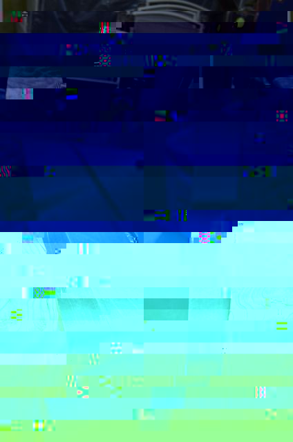

Post by 6burgh » Sat Feb 16, 2013 6:30 pm
Had a little time today to finish the front panel and begin the back panel (just birch, not the cherry). Everything dry fit looks good so far, so time to glue and screw!
