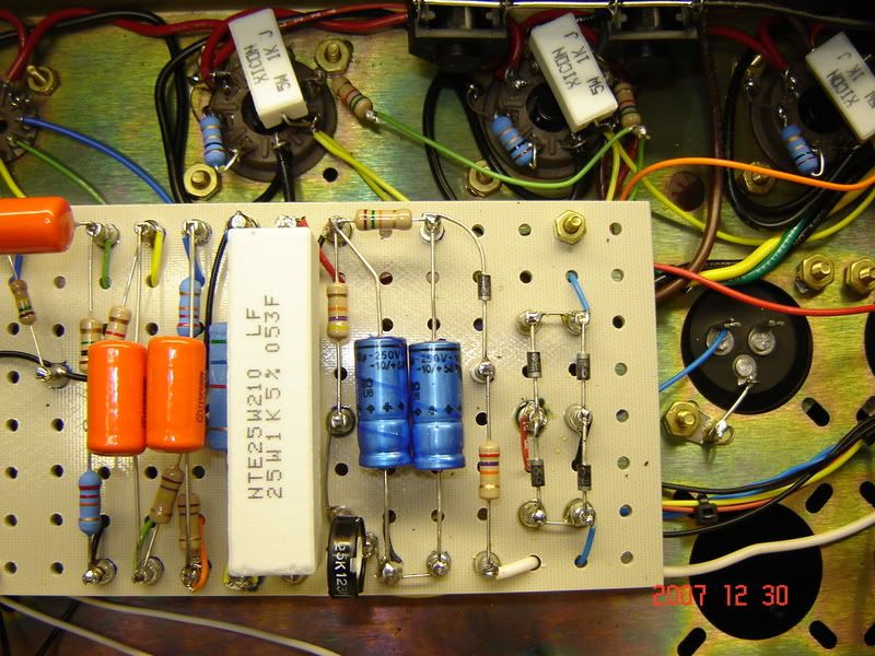

I use a turret staking tool and base from this guy:
http://www.turretboards.com/
Install the turret, turn it over and press it into the board, simple as that!
Here is a semi close up of the board I recently put some on....

The split top turrets use a special staking tool, I think it's bigger? Anyway it works great on the split top turrets George sells or the ones from Turretboards.comBilly Batz wrote:I have the hoffman turret staking tool for keystone turrets but it doesnt seem to work as good on these split turrets.

I made my own version. I took a 12mm bolt and nut (to make the hex head area wider so it stayed in the vice better) and drilled a hole slightly wider than that of the turret. That was my staking anvil. I use a large centre punch that ive rounded off slightly to splay out the bottom. I finish it by hammering out flat the turrt bottom with a small hammer. I get pretty good results from that though i have only made small one off mountings for rectifers and large fliter caps.

It was a blank board and I drilled it myself. I keep trying to get George to sell a template so we can use to drill our own boards but no luck. I used an old 10" perf board as a template then tape the two together and drill it out on my drill press. You may call and ask Turretboards if they will drill it for you.RoryB wrote:Hi Guitar Adjuster, did you get the board from turretboards.com pre-drilled or did you have to do it? Cos I'm trying to get a board thats predrilled like yours, with standard holes, for a non-plexi amp build.
