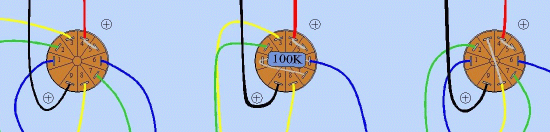

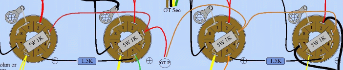

Here's a couple images that should help. There are layout diagrams on the Metro CD that show these also.
All of the preamp sockets have pins 4 and 5 tied together (red heater wire).
The second preamp socket (V2) has a 100k resistor between pins 6 and 1 and the pin 1 side lead ties to pin 7.
V3 has pin 3 and 8 tied together.
The power tubes have a 5 watt 1k resistor between pins 4 and 6 (large, sometimes rectangular).
Then they have a 1.5k between pins 5 of each pair. You can also put a 5.6k on pin 5 of each socket instead of these.
V1 can also have pin 3 and 8 tied together if you want shared cathode (remove yellow wire going to pin 8 ).
power tube sockets
preamp sockets

Some Marshalls don't have those resistors (aka "grid stoppers" or "swamp resistors"). A lot of 50w amps don't use them.
Their main purpose is to reduce parasitic oscillation, which is kind of like a very high frequency feedback above the audible range. Oscillation can cause red-plating in the output tubes and possible noise issues. There may be other purposes too. I'm not sure.
The main disadvantage of the 1.5k pairs in a 100w is that the pair of tubes that have the signal from the output coupling caps wired to pin 5 don't "see" the resistor. In the diagram above, only the outside pair are affected by the resistors.
Larger value resistors will roll-off lower frequencies. I'm not sure when this becomes audible but some people use up to 10k or higher there.
