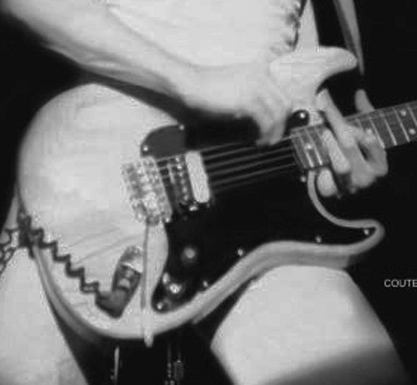

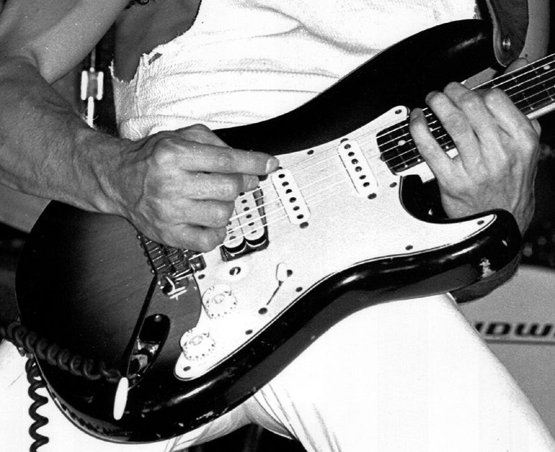

I have been looking at these two and I really can't see how the sunburst strat could be the same guitar as the unfinished Franky.jimi22812 wrote:Compare the grain patterns...garbeaj wrote: I agree that the sunburst strat theory has been decimated once and for all!
...cased closed?
There is a "V" pattern in the grain on both guitars, but the bottom line of the "V" on the sunburst strat cuts through the jackplate near the top.
The bottom line of the "V" pattern in the unfinished Franky cuts through at just past the midpoint of the jackplate.
Admittedly, I'm not as good at seeing these types of things as you are...what do you think?

Jimi posted those pics to show just how completely deferent they are. Remember this guy:
Well, If he has not already, I guess the honorable thing to do now would be to stick his head in the nearest oven.evhguitars wrote:FACTS: The EVH 61 SB Fender Strat body is the same body as the EVH black strat. The EVH Black Strat is the same body as the EVH Black and White Striped Strat. The EVH Black and White Striped strat is the same body as the EVH Black, White and Red Strat. There is no doubt, no mistake, no debate, no argument. Those are the simple and undisputable hard cold FACTS!

Hah! Well said! That unfinished Franky pic is fucking monumental...certainly the coolest thing since I found the color pics of the white Destroyer, but obviously even more important because it deals with the Frankenstein.Strat78 wrote:Jimi posted those pics to show just how completely deferent they are. Remember this guy:Well, If he has not already, I guess the honorable thing to do now would be to stick his head in the nearest oven.evhguitars wrote:FACTS: The EVH 61 SB Fender Strat body is the same body as the EVH black strat. The EVH Black Strat is the same body as the EVH Black and White Striped Strat. The EVH Black and White Striped strat is the same body as the EVH Black, White and Red Strat. There is no doubt, no mistake, no debate, no argument. Those are the simple and undisputable hard cold FACTS!
One thing that does appear to be sure is that Ed was using the same rosewood board strat neck with the oddly placed Fender logo on both the sunburst strat and the Jenny Lens black strat and one assumes the unfinished Franky...if only one could see the headstock on that unfinished Franky pic.
This all seems to point to a rosewood neck for the demos? Possibly the recording of the first album? I would say it is more likely for the demos, but who knows?
