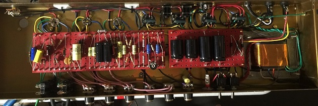

been quite a while since i've been here. figured i'd try to keep the dungeon alive.
built this with Ed's 84 live tone in mind.
classic tone PT
VZ OT
EHx fat bottles
bias'd for low input voltage
3H choke
2.7k on v1b.
new components except a Sylvania WA on V1 and Raytheon long black plate on v2.
https://www.dropbox.com/s/csfazzfa0sgdt ... M.mov?dl=0
I'm pleased with the build. there's a random squeal from the input jacks that i need to sort out. sometimes when the jack is inserted into the lower hole, the amp squeals and no guitar signal gets through. other times its fine. any experience there? planning on redoing the solder joints and possibly running shielded runs to V1.

That's awesome, you put the chassi in the tree. Sound really good.
