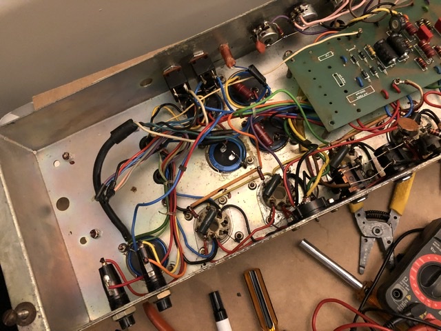

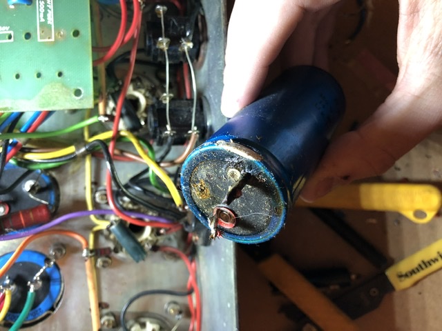

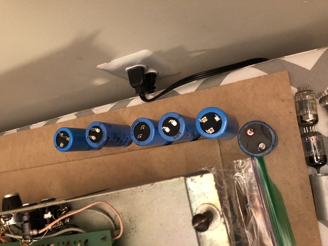

Here’s the status so far.
I have completed a recap job, I designed a dual bias daughter board that needs testing. I’ve designed and had made a replacement Marshall faceplate. The front doesn’t match the brushed aluminum back but I’m ok with that - this is a bastard build if there ever was one so I’d expect nothing less.
I have a DC heater supply for the preamp tubes and I’m floating the power tubes on 12V CT.
I ordered a variac, isolation transformer, and power meter to be able to turn it on slowly to test the recap job and the bias board.
I’m building the relay circuit now so that the stock switches can be used to turn on the DC supply without being damaged by the inrush current of it which they are not rated for.
Stay tuned!
Stay tuned!
