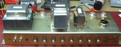

This Bluebreaker reissue is getting a complete rebuild. All Heyboer transformers. PTP board. Correct filter caps. The works.
I'll post the progress.

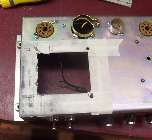

First, let me say that I filed that hole to size by hand. Looking back at the pics, it shows the rough cut and then the power trans in place.
I'm working on a layout for the replacement BB board with the new tremelo circuit in place. The original is just too crappy. I tried everything I could think of to optimize it. Well, everything short of putting a Mullard OC44 transistor in there.
This project is the prototype for the new layout, so the BB RI board is in sight. Sorry for the delay guys.
The Heyboer trannies are as good as the specs I have them built to. They build them right, with high quality materials. But it's up to me to give them the correct specs. So far, so good.

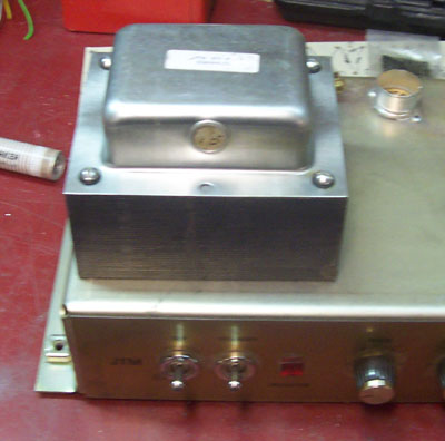

Hey Eric (he's the owner of this amp) you seemed a little uncertain on the phone. Maybe that first pic was too much.
I thought I'd better post the finished PT install to give you some peace of mind.
