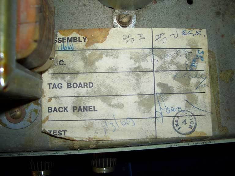

that is a picture of the inside of a real Hendrix amp #12361. The one that was supposedly his favorite one. It was for sale a few years ago and I got theise pictures of it. Notice both amps have .68 chiclets factory instead of mustards. Both amps are 69
Here is another Hendrix amp a 10xxx series 69 that does not have the mod. supposedly his favorite was the one above and had the split to shared cathode mod

I think the caps still hold power even when the amps off and you need to hook a wire to the chassis or something. I'm a bit afraid to mess with it, although I will sometime.
The other thing is that amp with the shared cathode looks like a rat's nest in there. The power cable looks like its been changed, and possibly the filter caps. You gotta wonder with it being in different ownership for 40 years if its been tampered with at all.
Looking at the split cathode amp - that one looks all original and untouched. Everything is neatly wired in there.
I think back then when he died they didn't think about the specialness of those amps - they were just amp's - not his guitars. Plus who would think that they'd go up in value so much because they dont make them like they used to.
I think one of the articles I read somewhere was a hendrix fan who saw one of his amps for sale a year or so after hendrix died.
Again who knows!
The shared cathode is something I'll try one day for sure though.
Again who knows!
