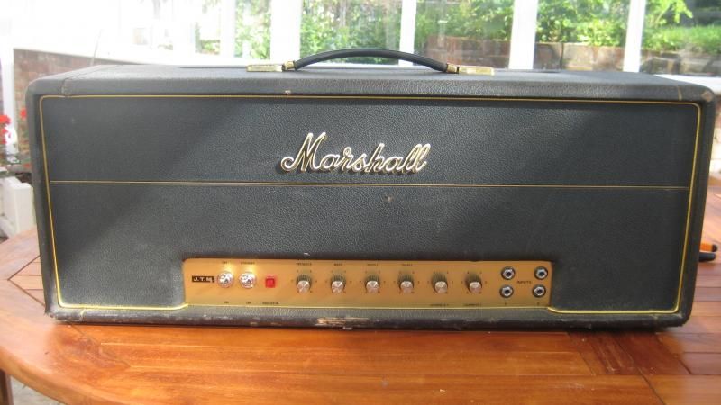

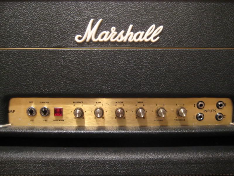

There are some other shots here:
http://forum.metroamp.com/viewtopic.php ... &start=314
The red one does not have the flat bottom. Looking from the inside, see the ridge on the front?
If you had the same look for the black one, there would be no ridge.
