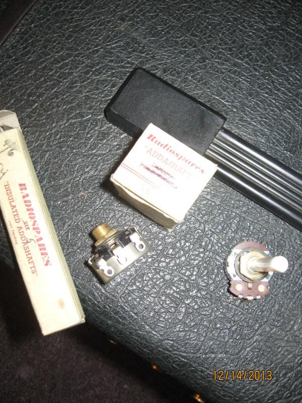

Finally found an original 5k pres pot for my 69 plexi. I got a reg body and large body 5k also some other values as well. They were the add a shaft where u cut the shaft to size and then push it in body!

Unusual for a 69 to use those pots (typically used 63 to 67) the CTS are more usual from late 67 to early 70s.

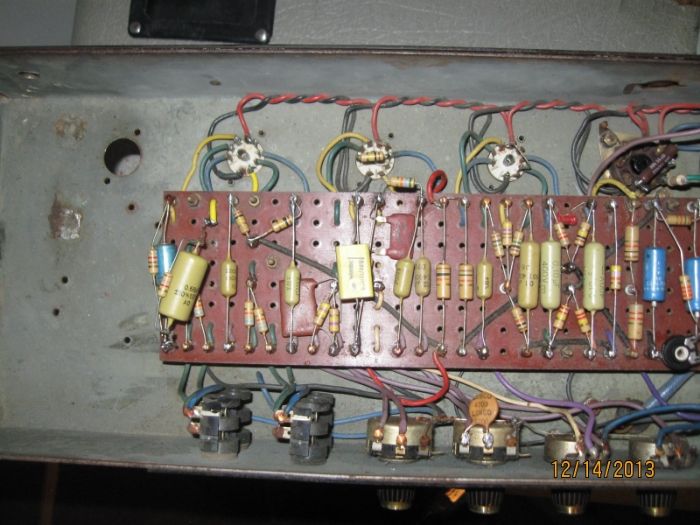

Here is a pic of my amp with large pots. The RS 5k new pot looks exactly like my 1 meg pots. This amp from 69 has the same pots and same color wires as mine. It was made 3/27/69 3 days after my birthday.I suspect mine was made close to the same time . It would Be cool if mine would of been made on my B-Day..However my sticker is long gone! Mark
Here is mine (1st pic)

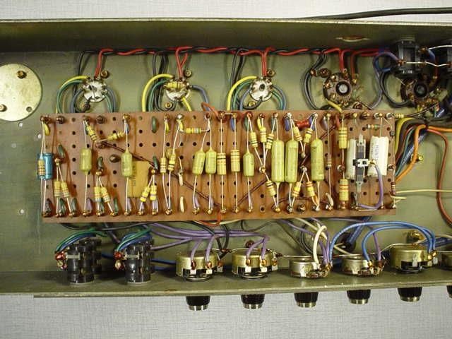

Hers a 69 superbass from amp archives notice the input jack and pot wiring.Id say the same person did this amp and mine. Hey Neil...Ive been reluctant to money/restore this amp I have but as you can see its far from mint.Would you leave it alone or give it a workover? Sounds fine but could be cleaned up some.

Yep looks right!
Interesting they must have got a batch of 1M Rs pots in (or found a box of them left over?).
Is yours back to stock now or are you still running it as a 'custom blend' of SB and SL?
Wonder how many amps had the presence pots replaced needlessly due to a 'scratchy pot'?

Actually, it's not that uncommon to see the large 2w RS pots (rebranded Clarostat) mixed with the CTS/AB pots in the '69 amps. Most of the time it's just the 1 Meg pots being RS, but once in a while you'll see a 5K or 250K RS mixed in with the CTS/AB pots. While I'm on the subject, sporadically Marshall used 1/2 watt DCC pots (for the 1 Meg), and also another RS rebrand 2w pot (looks like the AB or PEC pots) for the 250K in '69. As Neil mentioned, the CTS/AB pots were the "staple" from very late 1967 thru the late 1970's.
