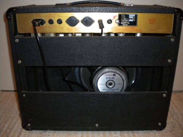

I am very familiar with, but with the the stack input version (only)
What years did these run in the '80's exactly ? ('81-'89?) - but with this stock speq. (only)?
Could I find an answer going by looking through Marshall Schematic's ? Thanks !Image

JimiJames wrote:I am very familiar with, but with the the stack input version (only)
Yes. The 65 watt Celestion, I've owned a couple of these amps..
JimiJames wrote:Could I find an answer going by looking through Marshall Schematic's ?
No on the speaker, yes on the release date of the amp.

Post by Janglin_Jack » Thu Nov 14, 2013 2:28 pm
Mine came with a a G12M-70, (I think - as I am not 100% now). I replaced it with a Heritage G12-65.

BTW & AFAIK the ones that I am interested in ALL had G12-65's and that's what I am targeting.

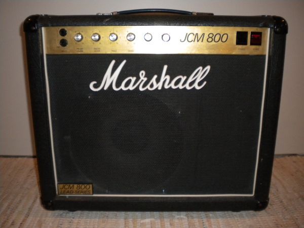

My last bit of info searchin' is that; in these models that were April/May 1984 and prior, what years came with Brown grillcloth and what years for the Black.

Brown grillecloth isn't brown at all, it is faded black (take the baffle boards out and you will see on the bits that haven't been exposed to sunlight). It was a different supplier or same supplier using a different dye, but it was only a temporary thing as it only occurred in 1985 and a final few 1986 amplifiers.
All G12-65's had disappeared by early 1982. Shame, as the 70's sound truly horrid in open backed cabs.
