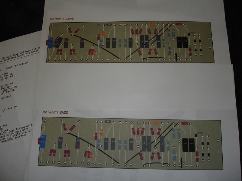

1st questions
My board doesn't have the same layout as the ones on the disk. There are no turrets for the SS recto. I noticed the lugs for the bias pot are not there either. Is this a mistake?

stokesdead wrote:1st questions

lets see some pics

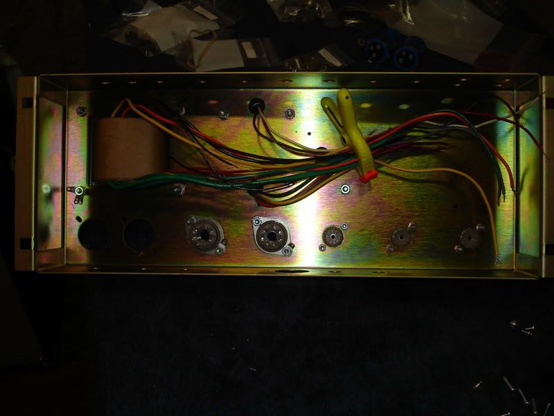

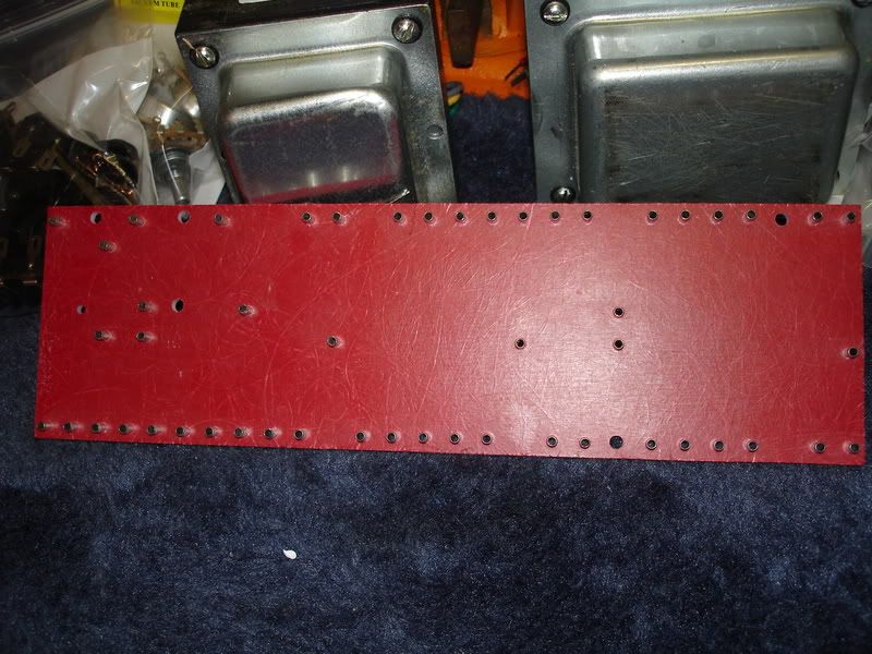

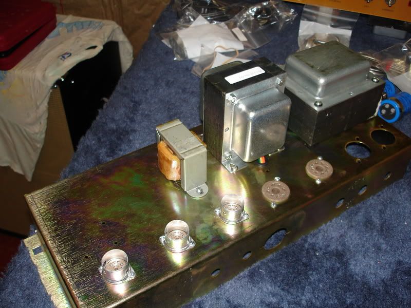

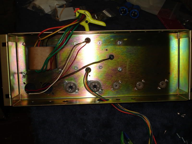

Post by stokesdead » Sun May 13, 2007 3:47 pm
Here's pics of the turret board which isn't the same as the layout.
I'm not sure what layout i'm supposed to use with this board.Thanks in advance for any help you can give me.
Aside from that, here's my progress on this chassis. Do you see any mistakes?
Thanks,
Chris Stokes

Post by gibboau » Sun May 13, 2007 11:36 pm
looks like a JTM45 board to me..

Post by stokesdead » Mon May 14, 2007 9:31 am
did I get the wrong board then?
