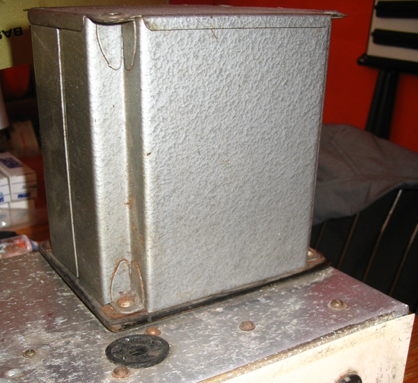

Are the big mains ones the same as this one ? (from a jtm45/100) ?
I love AMPS
Brian Wallace
Supporting Advertiser
Posts: 873
Joined: Thu Mar 03, 2005 10:45 pm
Location: Michigan
Big PT
Post by Brian Wallace » Wed Jun 14, 2006 7:08 am
Yes, Those are the same transformer.
