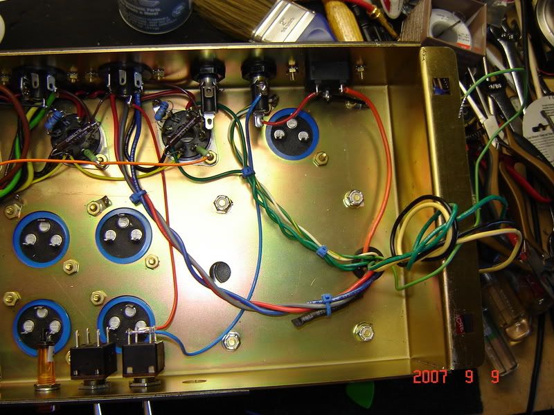

Post by Guitar Adjuster » Sat Sep 08, 2007 11:45 pm
I have seen it wired directly to the power switch and the power switch is wired to the Main Fuse and I have seen the common from the PT go to the fuse first. Which is the most common/correct way? I think they both serve the same purpose but just want to claify.

Post by Guitar Adjuster » Sun Sep 09, 2007 10:27 am
So, based on the info in that thread, this photo would be correct?

Post by novosibir » Sun Sep 09, 2007 11:58 am
Correct!
