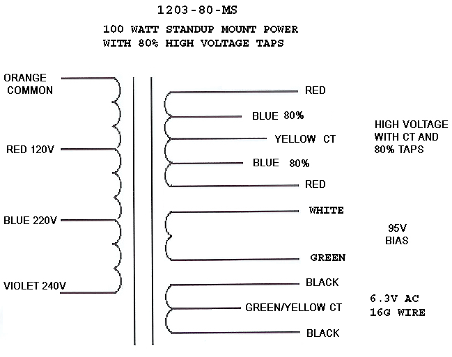

Upright Low Voltage Tranny Image
Post by Ian M » Thu Mar 29, 2007 2:15 pm
Hi George,
Does this image show the color coding of the new standardized upright power tranny correctly? I've been confused by this myself with my new kit, being a newbie to Metro.
Is the number right? Let me know if I need to correct anything.
Thanks,
Ian
Post by VelvetGeorge » Thu Mar 29, 2007 4:25 pm
Here's the updated diagram.
VG
