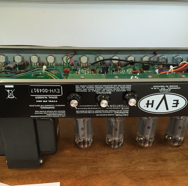

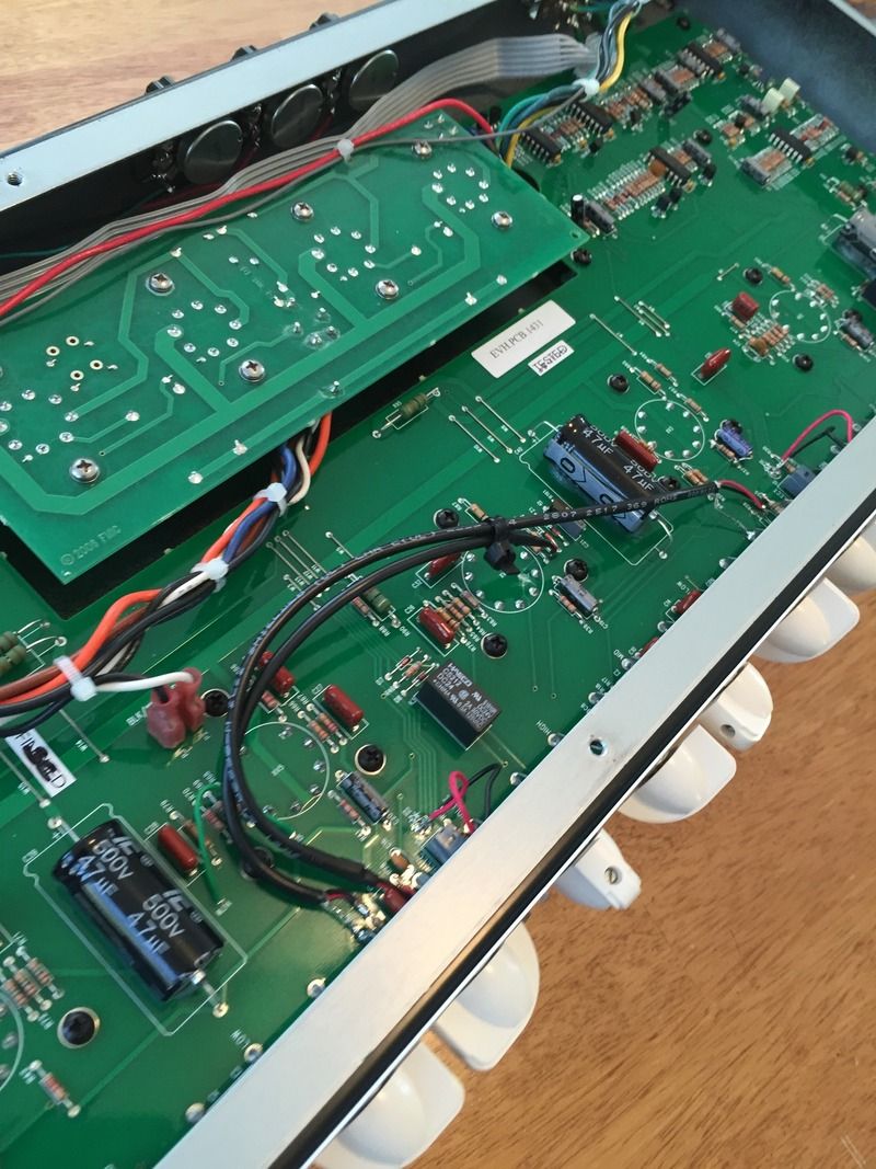

So it's remove R26, mod R25, jumper C23 if you have it, add the cap over R37 as described in the above link and do the jumpering business, in a nutshell. The main jumpering bit looks incredibly straightforward, just tapping off the signal right after V1A (red channel's first stage) and dropping it back in after V1B (blue and green channel's old first stage) - from the back end of C13 to the front end of R25. So V1B is now defunct and there's no switching before the location of the jumper so signal will just follow the new path. Bam. Add the resonance knobs and you have a Stealth. Great link.
