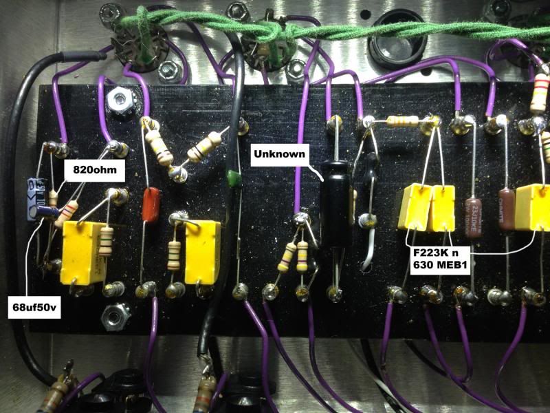

Hey guys, I am having a friend work on my 50watt Plexi clone. We are cleaning up a few things and upgrading some parts. First thing we are going to do is at a Bright Cap. There is no Bright Cap in my amp. If I wanted to turn the amp down and use a Les Paul for some other tones, it gets super dark. Don't know why there was not a Bright Cap originally put in it. I am going to assume that you guys have Bright Caps in your amps?
Second thing, we are going to install the new SoZo NextGen Caps. Right now there are; what I was told, Xeon or Xion? Can't remember the exact name of the caps. Gonna upgrade anyway. What do you guys think about that?

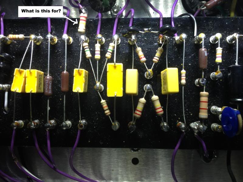

Now, here is the mystery for my friend and I. I took a look at 2 different 12 Series specs. There is a resistor leading to a preamp tube that we don't know what its purpose is. My friend had a couple of ideas. But we just don't know. Here is a pic of the resistor. What is it for?

It is a series dropper to the input grid of the PI tube, not seen one before,may have been to prevent oscillation, ?

This amp is actually a Blankenship VariPlex. Or it used to be. Its been converted to Plexi Spec. The OT is a Mercury Magnetics and says Blankenship on it.neikeel wrote:It is a series dropper to the input grid of the PI tube, not seen one before,may have been to prevent oscillation, ?

The soldering is a bit 'splatty'' - maybe whoever did the modding? Personally I find the MM OT a bit stiff and that the Marstran in my 2 in 1 is pretty hard to beat (although I do hear good things about Classic Tone and ****** for different reasons). I guess you see how far you can get with tweaking before an OT swapmotrock wrote:This amp is actually a Blankenship VariPlex. Or it used to be. Its been converted to Plexi Spec. The OT is a Mercury Magnetics and says Blankenship on it.

An OT swap seems more likely also. Might just leave the caps alone. Except; there is this big black cap that is still unidentified. The writing is under the damn thing and only way to find out is by yankin it. Its supposed to be the .68uF. My other amp was a cap that looked just like it; and it could be a 330uF. Which would kill what I want with the mids!

Then there is this issue of the big black cap.
http://i63.photobucket.com/albums/h147/ ... Board1.jpg" onclick="window.open(this.href);return false;
Not sure if its a 330uF or 68uF. 330uF would kill the mids. 68uF; according to the 68 12000 schematic I have, is what needs to be there!

You know, I was wondering that with the 330uF. And yeah, the 100k in the NFB loop is something this amp does not have; or a bright cap. Those 2 things will liven the amp up.
