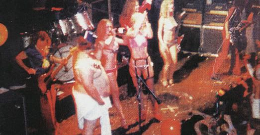

Post by leadguy » Thu Dec 16, 2010 12:16 am
A player can not get another players attack 100%.
I can not get Ralle or Rockstah's attack 100% or Ed's or Steve Vais or Angus's etc etc.
Plus there are a few things missing like the Variac and rebias, Echoplex and Phase.
The JBL's are not there in early 1978 which is after the VH1 recording date.
The JBL's are also not there around the earlier time of the Warner Brothers Demos (After Zero) around May/June 1977.
The raw clips Dave Friedman posted are 2 different mic position clips.
One mike up close and right on the centre of cone (the so called JBL) and the other mic angled and on the edge of the cone (so called Celestion).
It's really Donn Landee's way of micing.
The JBL's really came into it for the 1978 World Tour.
very late 1977
early 1978
May/June 1977

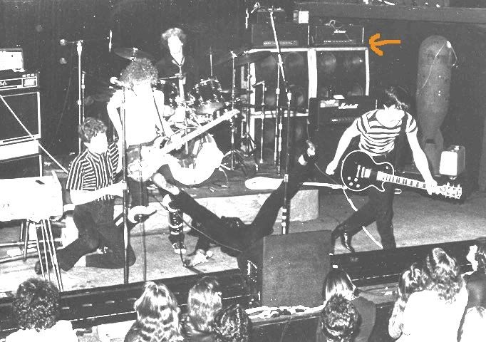

Post by Strat78 » Thu Dec 16, 2010 12:34 am
Some more clips need to be done with JBL's. I can see them in this Whiskey shot:
