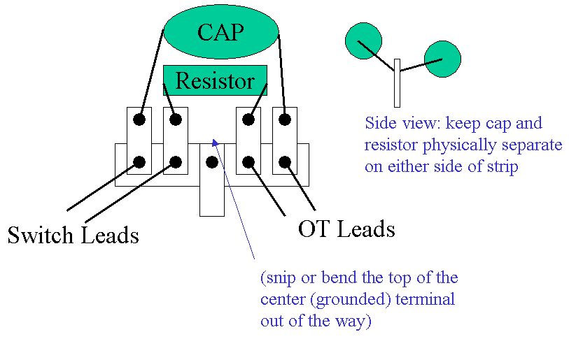

CJ
I think its called CJ Conjunctive Filtering I did it to my jtm45/50 1k 5watt in series with OJD .0015 cap pins3 V4 V5. I was warned its not good and all but my amp has been fine,ericopp wrote:I'm starting to wonder about a correlation betweem the resistor load box and the so-called "****** mod" that has the resistor(s) wired across the #3s of the power tubes.
All this talk about "big Ohmite" resistors hanging out the back of the amp leads to a lot of ideas...
- CJ
- conjfilterLayout.gif (9.98 KiB) Viewed 2722 times
