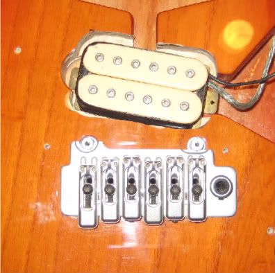

Post by StuntDouble » Fri Jan 15, 2010 2:06 pm
Does the spacing look right to you guys here? I had to be a bit careful as the wilkinson has the fulcrum points in front of the E strings, instead of further to the outside like the floyd. If I go any closer back towards the bridge, I'm afraid I 'm going to start removing to much wood too close to the posts. I've got my amp setup where I want it; I'm just dialing in my guitars and get a better recorded sound now. I took the MM 1300 out of the Destroyer and put my Ultrar 7T in there. It was a little too throaty with the MM for my taste. I'm going to give the MM a shot in this swampash body. I tried it in my mahogany body and it was really mean sounding, but not VH. There's something really Vh1 about this pup though, and I think if I had the right body, it'd be there. Unfortunately this was the closest I could get with a straight trade for my Mahogany body...clips soon I promise. 8)

Post by Strat78 » Fri Jan 15, 2010 7:57 pm
StuntDouble wrote:Image
Great seeing the shot of your vintage Mighty Mite! Maybe the angle is a bit too much?. Put the strings on and tune it up and do some real time placement with the amp on. I would move the bottom away from the bridge about 1/8" (see how it sounds in both spots). You want the low E string to be picked up by the back top pole piece and the high E to be picked up by the lower front pole piece, this makes the low strings less muddy and the high strings fuller (of course you knew this, but just let me bloviate). In a way it simulates a single coil that is angled the opposite way which makes allot of sense.
I know what you mean about the throatiness of the old Mighty Mite pickups, but if you lower the pole pieces it seems to reduce that compression. I've left the ceramic magnet in my latest set up because after hearing the iso ITO tracks, Ed's tone kind of has a ceramic vibe. I've got to try it through my Marshall before coming to any conclusions. Still, I'm hooked on these mid 70's Mighty Mites (been getting them for nothing on eBay lately), they have a snarl that you can sink your teeth into. I picked up a zebra mighty mite #1400 (like the one in Ed's Whiskey Franky?), for $16, and the thing totally sizzles! I thought they were suppose to be wound like a PAF, but it is more like 14k. I think this was the pickup on the first album, maybe. 8)

Post by StuntDouble » Fri Jan 15, 2010 9:37 pm

Ok is this angle a little better? I think I'm going to have to put some little washers under the baseplate to get the pup a little closer to the strings. How does the MM 1400 differ from the 1300. I remember seeing an old MightyMite advertisememt, and I remembered thinking that it was supposed to be more like a PAF; is it hotter than the 1300?

Post by Strat78 » Fri Jan 15, 2010 10:41 pm
Looks great! I like that angle aesthetically and also because you get a little more bass on the high strings and treble on the low E. It seems like the #1300 and the #1400 are the same, at least the one I have. The #1400 is a little hotter but thats it. I've got to try an A5 magnet in it eventually.t. Now my Whisky strat is complete with the pickup and now a bone nut (the bone sounds pretty much the same as the brass nut, but slightly warmer).

Re: EVH Tone - Pickup Roundup
Post by Tone Slinger » Sat Jan 16, 2010 10:52 am
I think that the pu in Ed's late '77-'78 era b&w Franky wasnt as close to the bridge as whats in that Honey colored guitar. I think that the angle doesnt neccisarilly accentuates the low strings to have more bite and the hi ones less bite. Both poles still pick up vibration. I think it simply gets more 'focus' when done like this, though to some extent the closer pole piece would have more 'say', so , yeah lower strings might have a little more sizzle.
I think Ed's pick up looked a bit further from the bridge in '77-'78. The R.B and W era floyd version I'm not sure about. Ed probably changed the pu position.
Ed seemed to be able to clean his sound up VERY well by rolling back his guitars volume. Ceramic magnets seem to get muddy when doing this. Does the mm's clean up well ?
