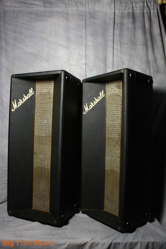

marshall PA cab?
http://media.photobucket.com/image/mars ... 5.jpg?o=20" onclick="window.open(this.href);return false;
ive owned a pair of these in the past and they do sound awesome with guitar, but they are pretty ugly and very cumbersome.

Those are some cool PA speakers. I'd probably still change out the 10" for 12".

you could easily fit three 12" speakers in one of those, but it would be incredibly heavy. theres a lot of wood in them pa cabs. the backs are solid birch ply too if i remember rightly.

all the pa cabs I've seen have been much lighter than the guitar cabs - the wood is much thinner
well, then they are different from the vintage marshall PA cabs I've seen

trust me, those early 70's marshall ones in the pic above are definitely not light. they might only house two speakers but they are tall and wide. big mofos. the wood is no thinner than on a standard 4x12. notice how slim the grill cloth is and the amount of wood surrounding it making up the 'frame'. = heavy.
