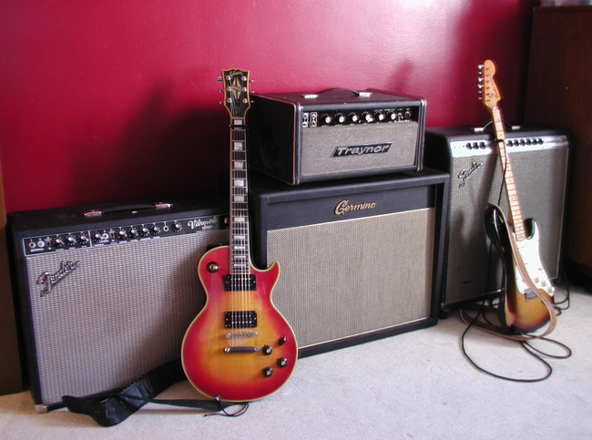

Just got this speaker friday. I wanted to check out if I liked the H55 or the M75 better. I think I dig the midrange tones of the M75, so its a keeper. But don't hold me to it! All of scumback speakers are top notch!
http://tylergrund.com/mp3/traynor_m75.mp3
Any scratchyness you hear is coming from the PPIV master being down pretty low. Not the speaker's fault. Sure with I could get my UA to work with my Traynor!!
...and a quick lower gain one when my wife came in and told me to turn down...even lower then I already was! HA!
http://tylergrund.com/mp3/traynor_m75_lowergain.mp3

Nice clips! Traynors kick ass. What exactly did you do to yours? Any gutshots? And how come the UA won't work with it?

Kevin wrote:Nice clips! Traynors kick ass. What exactly did you do to yours? Any gutshots? And how come the UA won't work with it?
I'm using M75s with mine, but I would like to try some H75s. Any clips with the H55s?
Its converted to Marshall Bass/Superbass specs. Don't have any gut shots, but these traynor's are not very pretty inside:) Whats nice, though, is they come fully decked out with real mustard caps.
THe 8ohm Traynor Transformer caused an arc on my tube socket and blew out tubes when running it into the 30ohm in of the UA. I plan on buying a Marstran transformer, when they get more stock in, and hook it up to the 16ohm tap. Until then, I'll live with the PPIV.
I have an H75 paired with the M75. Highly recommend. Not sure if I like the H75/H55 or H75/M75 combo better...but I do know I like the M75 by itself MUCH better then the H55. H55s are very scooped sounding and I really thought it sounded sorta harsh on its own.
Sorry, no clips of anything other then the M75 for now. I should take the time to do an H75 clip though. Stay tuned;)

I have a '72 YBA-1. I cleaned up the wiring, replaced the filter caps and tweaked the circuit a little.
I don't know much about the UA, but you could try running another load in parallel to it - just some high-wattage resistors to give that OT something that it likes a little more.
I find this really intriguing. I was running my 1968 YBA-1 with a UA for a while and now my Traynor has lost it's "Magic". It is not as open sounding and periodically the volume jumps up and the magic is back then it dissapears. I have tried replaceing the tubes to no avail.
Is there a chance that I have damaged my OT?

Apprently HO's design can be made in a lower OHM then 30, but he says it sacrifices the effect of the UA...
My concept of replacing the tranny is two fold. FIrst and formost is simply to save the original from disaster. Two would be the more Marshall correct sounding tranny. I DO like the traynors sound. This situation is going to simply create a reason to swap them out and give it a try. I actually think the traynor tranny might be superior to Marshall Iron, I just simply can't use it with the UA. So... if the UA and the Marstran sound better then theTraynor Iron and a PPIV...it stays. Otherwise. Traynor Iron goes back in, and UA goes on eBay;)
I probably will hold onto the transformer, but thanks for the offer. I'm really into amp mods and building, and can definitely find a use for such a killer tranny. Can someone say trainwreck?! :)

I'd say its possible. But I have no way of knowing on this end. It sounds like its possibly has a small internal short. Just enough to damage the output from reaching its peak. Not really sure.
But... these traynor OT have a 3600 ohm resistance at a normal 8ohm tap. So its a little rougher on them vs. normal marshall transformers (at roughly 3400) and I think they are more sensitive to the missmatch.
4:1, I think, is proving to be too much of a missmatch for the UA. 16ohm seems to be the only way.

Nice clips Gamedojo! Do you have a YBA-1 Bass Master or a YBA-1A Bass Master Mk II? I can't really tell from the pic but to my ears it sounds more like a YBA-1A?
I have a '71 YBA-1 and a '72 YBA-1A both in stock form. I'm on the fence to whether I keep them stock or mod one them to Marshall specs. To be honest, I never had the chance to try a good 50w plexi (I've just heard some live or from recordings) so I don't really know what to expect if I mod one.
