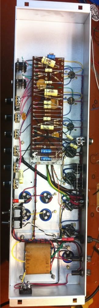

parasitic oscillation. can you post a clip of the amp making this sound?
lead dress and grounding as well as filtering can contribute as well as will resolve this if it is what i think it is.
can you post pictures of the chassis as well?

Post by Brandon » Thu Mar 10, 2011 11:29 am
EDIT: bigger photo

Post by rockstah » Thu Mar 10, 2011 11:50 am
checked the bias on it?
i would swap out the 1.5k grid resistors on the two outer two power tubes for 5.6k's on all of them.
Re: Weird Sound Coming From Amp/Cab
Post by rockstah » Thu Mar 10, 2011 11:55 am
someone can correct me if i'm wrong but that PPIMV is not wired correctly.
i believe the pot should be grounded and not to the bias supply.
Post by rockstah » Thu Mar 10, 2011 3:13 pm
i believe the master is wired in correctly. with thats style of master,keeping the existing bias feed resistors(220k's), the pot needs to go to ground and not the bias supply.

toner wrote:Your clip does sound like PO to me. That extra "sizzle" on top of the notes. Just to confirm, is it doing this with the amp mounted in the head cab?
It doesn't sound like the speakers are the cause. You could try another speaker cab to make sure but I think it's the amp. Is this the amp George built?
Like Mark said, you can try 5.6k resistors on pin 5 of all four power tubes. Also try lifting the green wires on the preamp tubes up away from the chassis.
