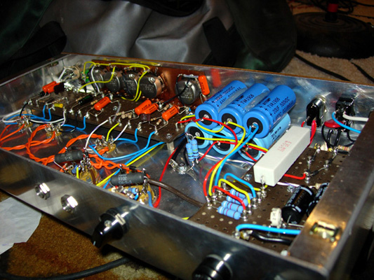

I just finished my Trainwreck after seeing gnugear's over here. I just copied the layout from the Fracesca pics at ampgarage. I gigged with it hours after I finished it, I'm pretty blown away by it. Phil :D
