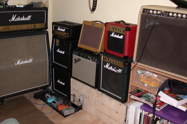

I have a few vintage amps. While most sound good, I have noticed that my 1959 5F1 tweed champ doesn't sound quite like I expect it should. I'm thinking that changing the capacitors might be what's needed to get it sounding it's best.
What worries me is that right now it is 99% original (non-original tubes) and just about dead mint. I own the amp because I love to play it, but I also have to think about my investment.

- amps2.jpg (77.31 KiB) Viewed 1711 times
