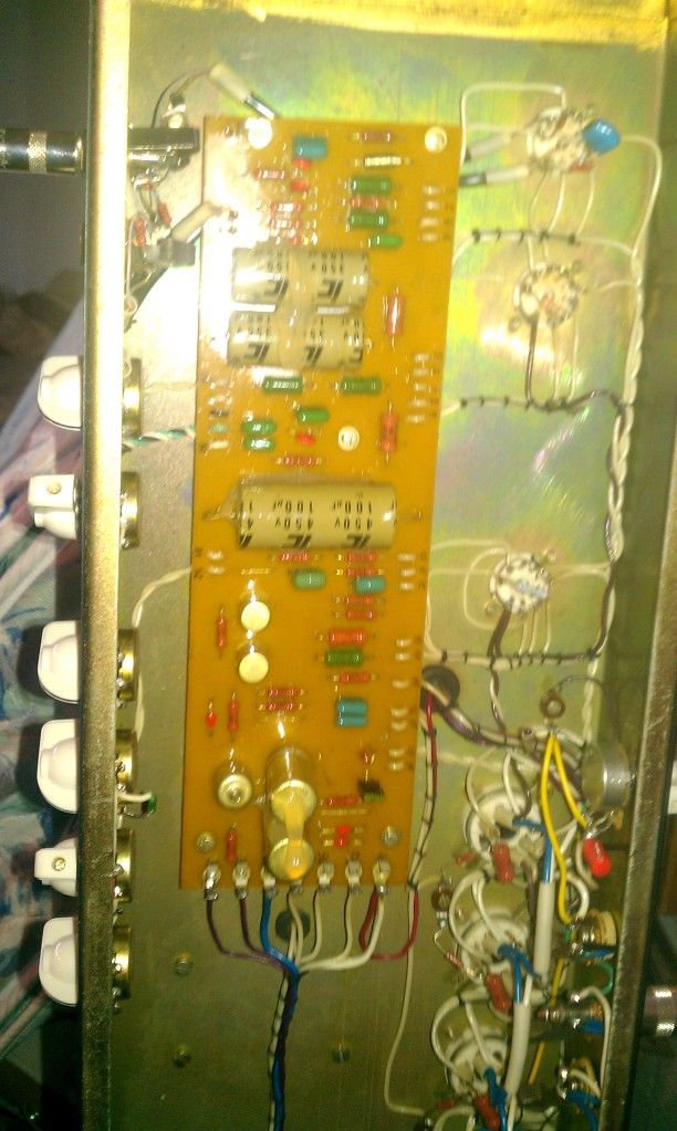

If you post a picture of the board i will tell you exactly what you need to do. Probably a 1uf cap on the cathode resistor of the second gain stage will do it. But.. If you want to make it a fire breathing gain machine you can, you just need to change most of the caps and resistors on the the first two stages of gain.. How much experience do you have working on electronics? Do you know how not to shock youself? You can get these amps very high gain with a little work, without adding another tube.

Image and yes i have worked on amps and know to drain the caps. i have taken a class on electronics yrs ago but just have some issues knowing what each part does in a tube amp.

Here is the scematic, higher gain than i expected... But probably kinda honky due to the. 047 coupling cap.

On he first gain stage, i would change the 100k plate resistor to a 220k with a 470pf disc bypassing it. This will lower the plate voltage from abour 250v to about 170v. This might be all you have to do, it will lower the clipping point of the tube and sound good. If you want to go bigger change the .47 bypass cap on the first stage to a 1uf capacitor. This will make for a smoother let honky gain. But you will probably then want to change the coupling cap from .047 to .022 or even .010 to filter out some of the low lows the 1uf will add. Then... I would change the 22uf cathode bypass on the second stage to a 1uf or a .068uf cap. It will make the amp tighter and just sound better in my opinion. Also i would concider a resonance mod on this amp. Ive added them to similiar circuits and they sounded great!

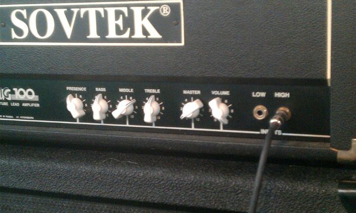

Image and i already did a depth or resonance control on it helped alot but what i am after is a more zakk wylde/ randy rhodes kinda sound...
also i am not well enough versed with tube amps to know exactly which part to change via your last post alil more guidance would be greatly appreciated
